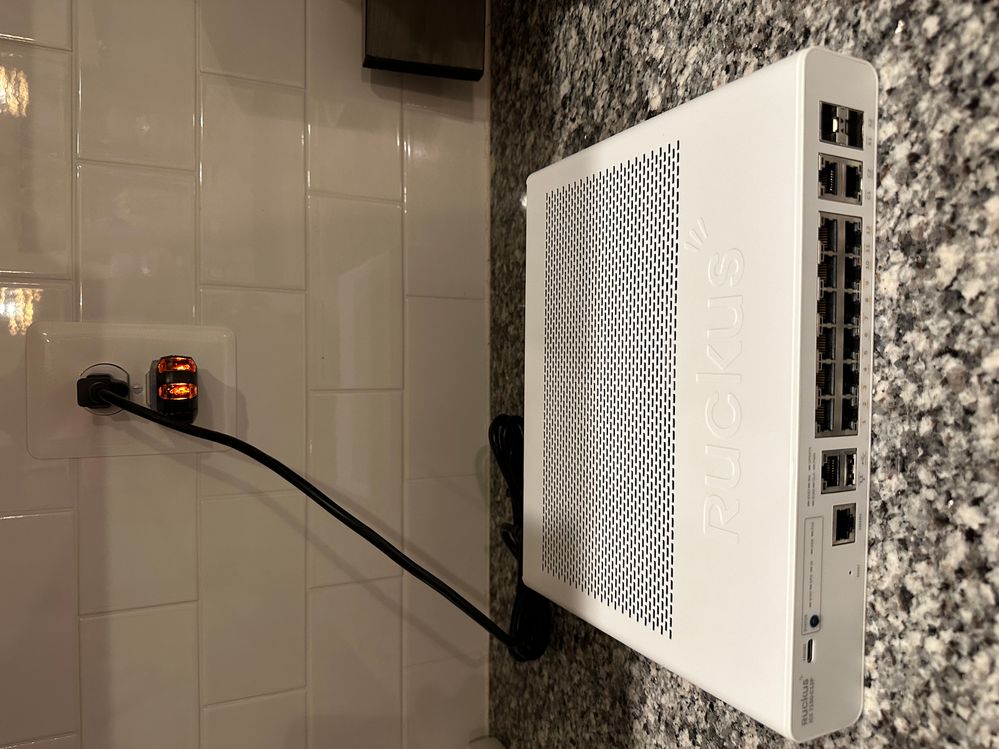

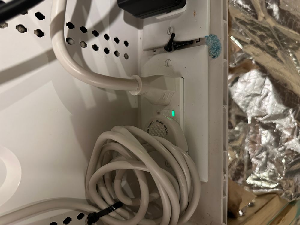

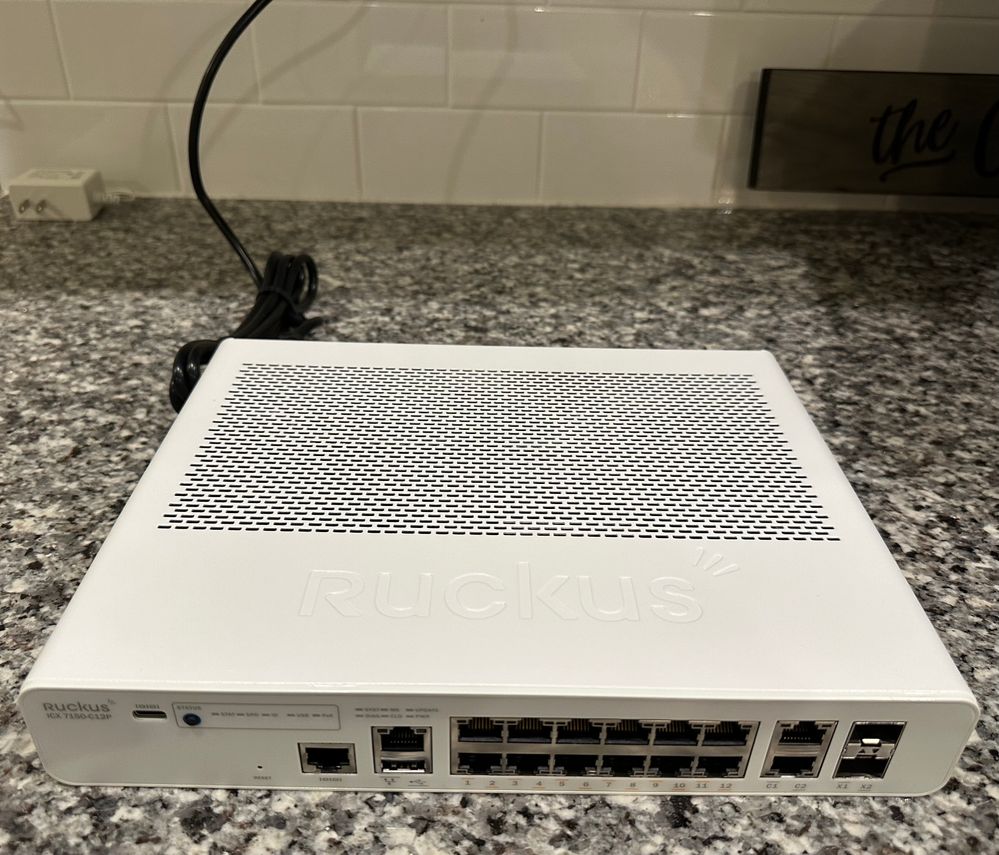

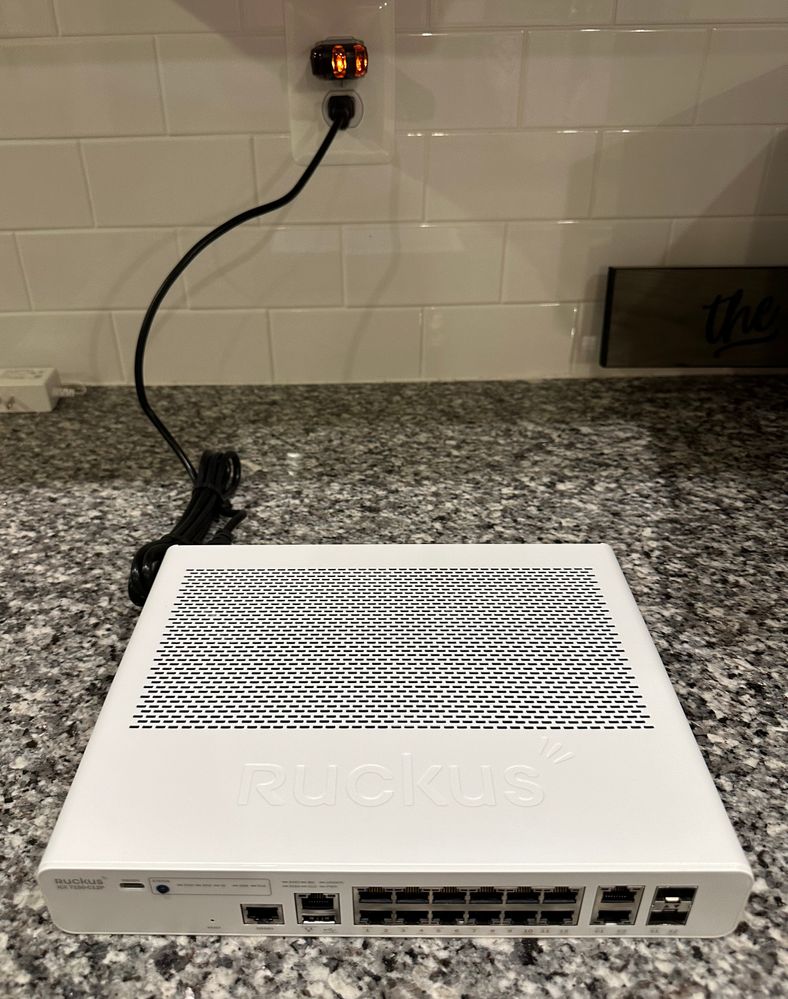

My Ruckus ICX 7150 switch went out this evening. I have read through several of the posts, tried the troubling shooting options for hours and the device will not turn on. I have taken pictures and video per the request in other posts. I have included the pictures below and uploaded the video to the google url. I look forward to any further assistance you can provide.

Thank you for sharing the requested PICTURES and a VIDEO.
Based on the troubleshooting done, your ICX-7150-C12P Switch is not powering up, and when plugged in, it flashes an amber light and then goes dark. And you confirm that the Switch is plugged into a well-known outlet/power source and tried to reset. However, the failure persists. This Switch unit Should be RMA (Return Merchandise Authorization) in simple words replacing it.

We appreciate the information you have provided regarding the issues with your RUCKUS ICX-7150-C12P not powering up.
To further diagnose the issue with your ICX-7150-C12P Switch, we kindly request that you connect it to a functioning power outlet and provide us with both pictures and a video (As the video you shared does not meet showing the required information) showcasing the current status of the lights, along with the cord connected to the Switch and a working power outlet. For your convenience, we have provided examples below for reference.

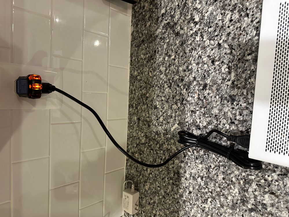

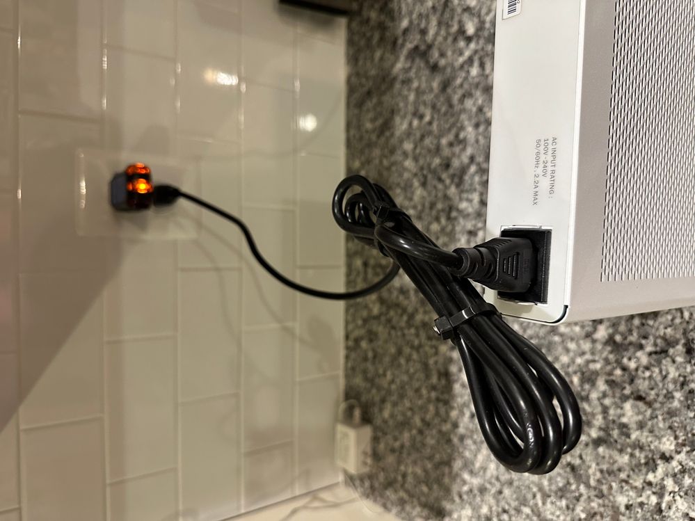

Attached are the the additional photos that you requested. I have also uploaded a new video.

Could you please confirm if the all the Switch LEDs blink amber and goes dark as soon as you plug it into a power outlet?
Please confirm.
07-02-2024 07:53 AM
Hello Imran,
Yes, that’s correct. As soon as you plug it in the lights flash really quick and then go out. If you blink, you’ll miss it. Thank you!
