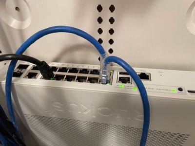

My Ruckus keeps showing heartbeat loss and internet drops. I have an account on the unleashed app but it also says I'm not the manager but i’ve been able to use the app.

As I observed from the picture you shared, seems like the ethernet cable which is coming from the Router or Modem/Router combo is plugged into the wrong port on the Switch panel. It must be plugged into any 1 in-12 ports as shown in the below screenshot. Please unplug the ethernet cable and plug it into the correct port and try the Internet connectivity and heartbeat loss again. If required, reboot the Switch once (disconnect and connect the switch from the power outlet), after you plug it into the correct port.

 I changed the ethernet port but my switch still says disconnected

Could you please confirm if you reboot the Switch as mentioned in my previous post?
If yes, please try to find the IP Address of the Switch now, as explained previously.

Hi @Ccaley98
As you have plugged Router ethernet cable to a correct port now, please run IP Scanner once again and try to find Switch IP Address.
