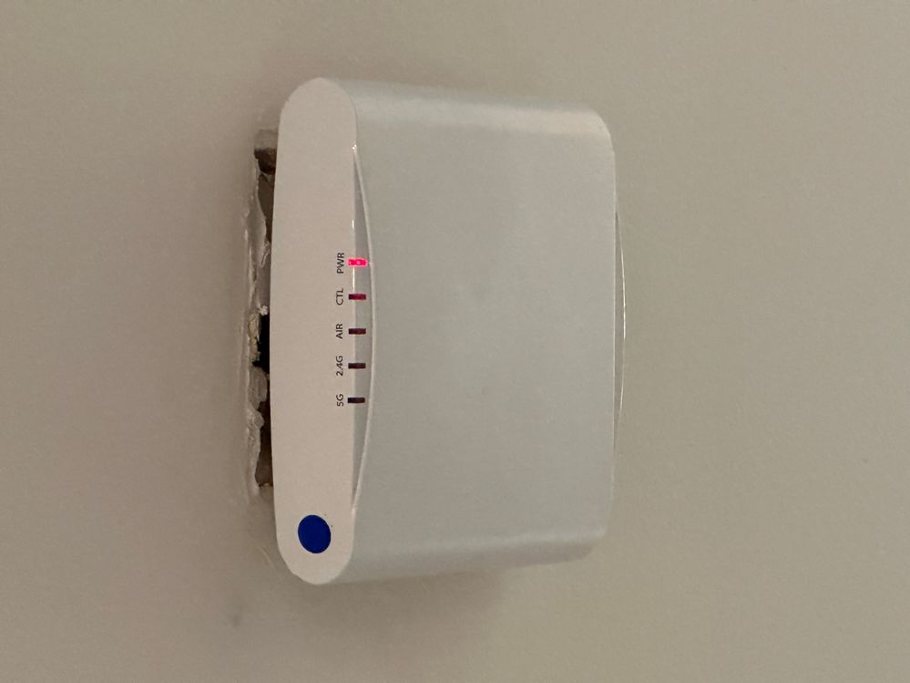

My switch seems to be okay with green lights but my phone can’t find the wifi name anymore.  My 1st floor access point has a solid red light and the 2nd floor has a solid CTL green light and a green flashing PWR light.  I tried factory reset but nothing has changed

Based on the troubleshooting done, and you confirm after performing the reset of the Access Point, and checking all the connectivity and connections, the failure persists. And this is the only ONE access point that isn’t working with Red PWR LED on it even after checking with an external power adapter it behaves the same. This ONE Access Point Unit Should be RMA (Return Merchandise Authorization) in simple words replacing it.

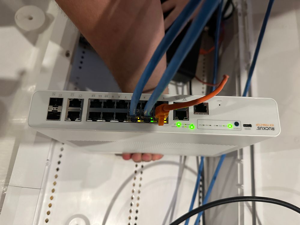

To better assist you, could you please provide us with a picture of your ICX-7150-C12P Switch? We kindly request that the picture captures the cable connections to the Switch ports, as shown in the example picture provided below:
Prior to uploading the photos, please ensure you are logged in to your RUCKUS account. You can then proceed to upload the image for our review.
Once we receive the requested image, we will be better equipped to provide you with further assistance.

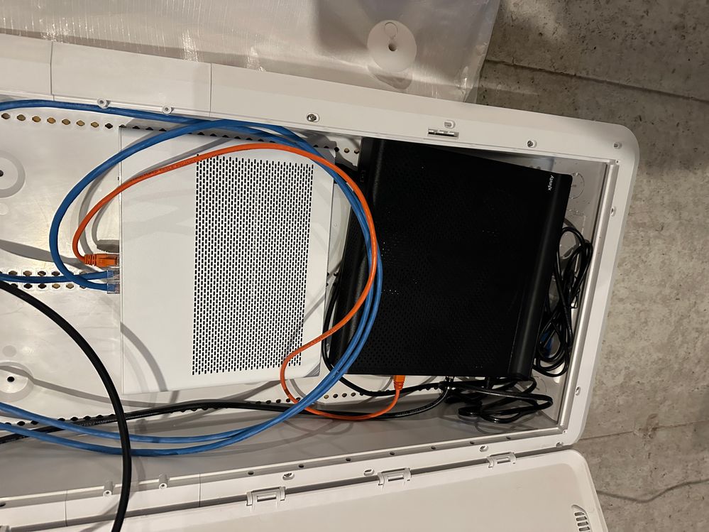

I attached two pictures of the Ruckus ICX and also a picture of the 1st floor access point with solid red light and the 2nd floor access point with solid green CTL light and slow flashing green PWR light
IMG_0869.jpegIMG_0870.jpeg1st floor R5101st floor R5102nd Floor R5102nd Floor R510

1. Please unplug the ethernet cables connecting your RUCKUS Access Points (APs) from the current ports on the RUCKUS ICX-7150-C12P Switch.
2. Plug these ethernet cables into any other available 1-in-12 ports on the switch, as illustrated in the screenshot provided.
3. After repositioning the cables, proceed to reboot the RUCKUS Switch by unplugging it from the power outlet and then plugging it back in.
4. Once the switch has rebooted, please verify the internet connectivity status.
Please follow these steps and confirm if they resolve the issue.
Thank you once again for your cooperation and patience. Should you require further assistance, please do not hesitate to reach out.
