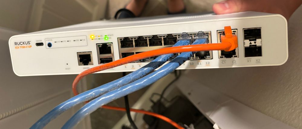

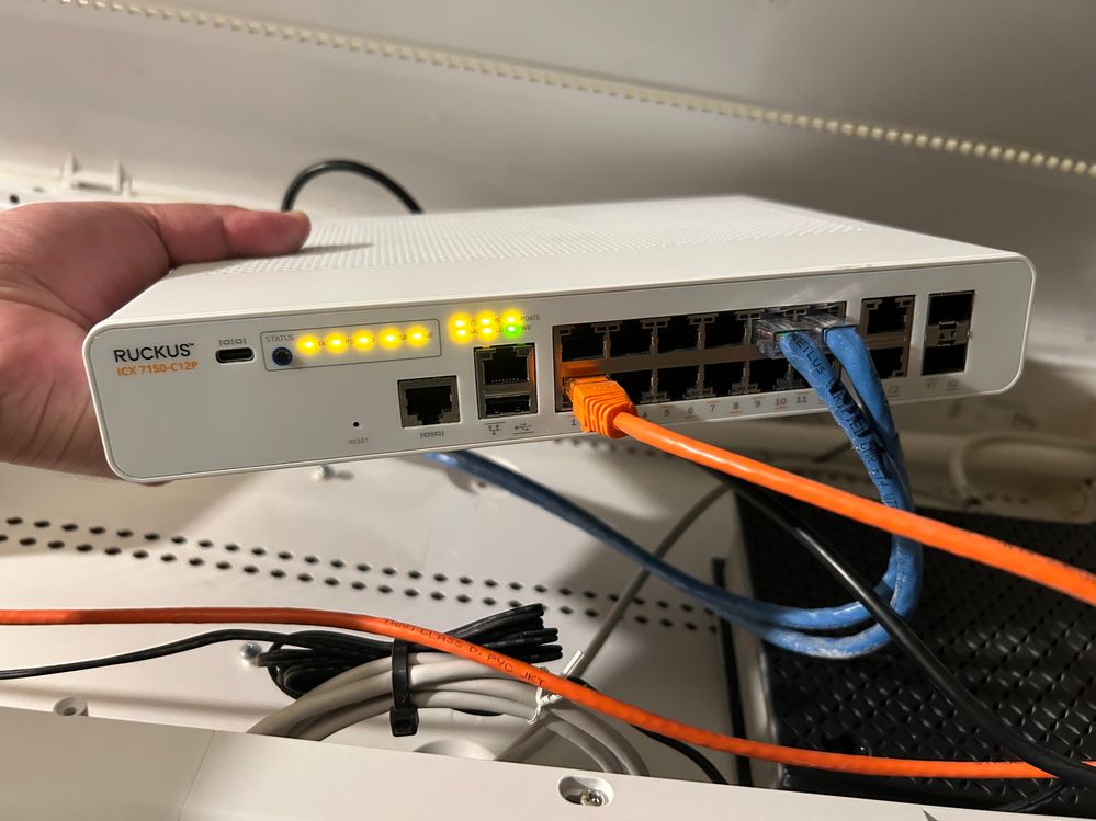

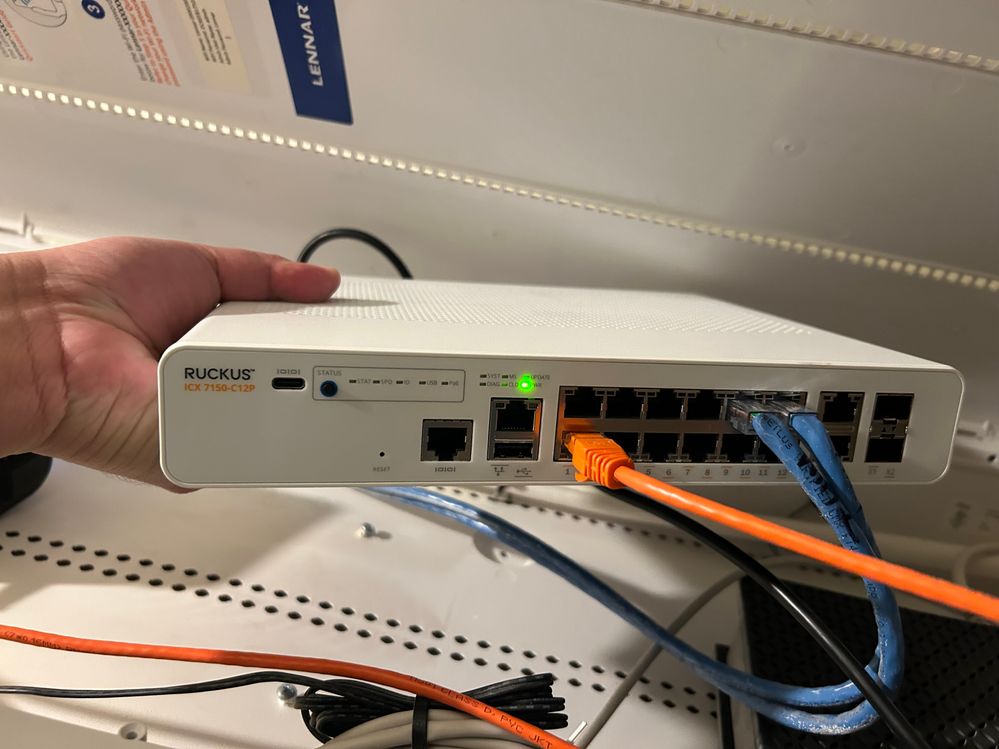

2. On your switch while it's plugged into the outlet, do you see any lights on? (Amber or green) Please let us know which lights are on. (Please refer to the below picture and share a picture of the same, showing the light status and the FULL Switch panel cable connections to the Switch ports) system light is on as yellow, pwr light is on as green

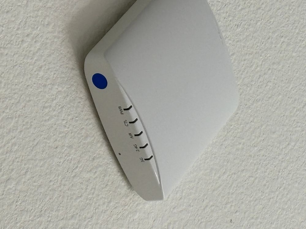

4. May I know how many Access Points are connected to the Switch? Could you please let me know the light status on the Access Points? Any of these lights are on (Please refer to the below picture and share a picture of the same)
There are two access points connected. There are no lights turned on on the access points.IMG_2469.jpgimage_50345729.JPGimage_50370561.JPGIMG_2466.jpg
Hi @erikdgreat13
As I see from the screenshot you shared, there is an Amber/Orange light on SYST and a Green light on PWR. It means that your RUCKUS ICX-7150-C12P Switch is stuck in boot mode. Please refer to the below RUCKUS Lennar Knowledge base self-help guide to troubleshoot the issue.
https://community.ruckuswireless.com/t5/RUCKUS-Lennar-Support-Knowledge/Fixing-RUCKUS-Switch-with-an...
Also, please note. seems like the Orange color ethernet cable which is coming from the ISPโ€™s (Internet Service Providerโ€™s) Router or Modem/Router combo is plugged into the wrong port on the Switch panel. It must be plugged into any 1 in-12 ports as shown in the below screenshot. Please unplug the ethernet cable and plug it into the correct port.
Please follow the above boot mode process and let me know if you have any queries in this regard.
