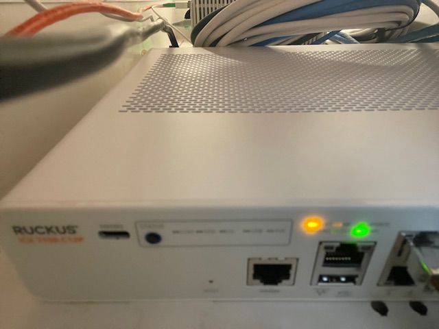

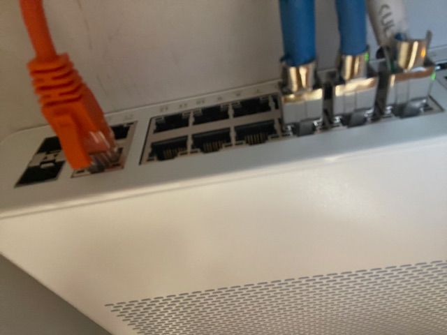

When your switch is connected to the outlet, do you observe any illuminated lights (amber or green)? Kindly describe which lights are visible. Additionally, please provide a photo showing the status of the lights and the full switch panel with cable connections to the switch ports.

I have uploaded 3 photos above. I took a video as well but it will not let me upload it.

Hi @MoLennarHome
Thank you for the response and the information shared.
From the picture you shared, I see an Amber/Yellow light on the SYST LED of the RUCKUS ICX-7150-C12P Switch. This means the Switch is stuck in boot mode.
To troubleshoot this issue, please refer to the below RUCKUS Lennar Knowledge Base self-help article.
Please let me know if you are stuck at any point following the steps.
