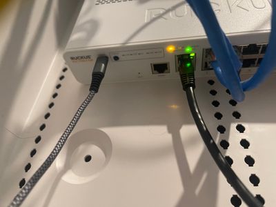

I had a power outage last night, but when the power turned back on my Ruckus R510 Access Points did not turn back on. I do have internet access through my internet providers router (Cox). I have unplugged my ruckus CX 7150-C12P several times and plugged back in. The CX 7150-C12P does have a green light indicating that there is power. The access points to not have any lights turned on. I’ve tried accessing my network through the unleashed app, but I get an error and am unable to. Please help me restore power to my access points. Thank you!

Based on the troubleshooting done, your ICX-7150-C12P Switch is stuck on boot mode and not working with physical resets multiple times. You tried to perform software recovery with different devices with no luck and the failure persists. This Switch unit Should be RMA (Return Merchandise Authorization) in simple words replacing it.

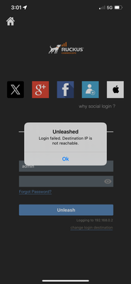

I have received my RMA and my lights are now all green and power has been restored to the access points. I see my network back on my list of WiFi options but I am unable to connect to it. It just keeps spinning on my phone and I’ve tried to forget and rejoin but that doesn’t do the trick. I’ve provided screenshots. Please assist.

I followed the instructions to access my ap and find the IP address for my new ruckus but was unable to locate it. I’ve downloaded the fing app and entered every single device IP address into my browser and none pull up any sort of ruckus log in.
I then go into the unleash app and try changing the login destination but it says that it is unable to find it. I do not remember the password for the ruckus app but when I try to reset the password it tells me that I am not connected to a ruckus network which I can not do because my device will not connect and I can not find the appropriate IP address.
also noting that there are green lights on both of  my access points and I have tried rebooting my router and also deleting and reading the ruckus app.
