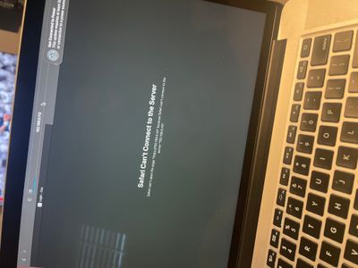

I have received my RMA and my lights are now all green and power has been restored to the access points. I see my network back on my list of WiFi options but I am unable to connect to it. It just keeps spinning on my phone and I’ve tried to forget and rejoin but that doesn’t do the trick. I’ve provided screenshots. Please assist.

I wanted to provide additional information as I’ve continued to read through other forums and follow the steps, but have not been able to resolve the issue still.
I followed the instructions to access my ap and find the IP address for my new ruckus but was unable to locate it. I’ve downloaded the fing app and entered every single device IP address into my browser and none pull up any sort of ruckus log in.
I then go into the unleash app and try changing the login destination but it says that it is unable to find it. I do not remember the password for the ruckus app but when I try to reset the password it tells me that I am not connected to a ruckus network which I can not do because my device will not connect and I can not find the appropriate IP address.
also noting that there are green lights on both of my access points and I have tried rebooting my router and also deleting and reading the ruckus app.
