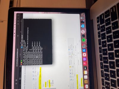

Hello Imran,
the software update didn’t work. I have a MacBook and the instructions say to make updates through the terminal. When I try following the guide it’s not displaying what the instructions say it should.

Hey Imran,
it didn’t work on my mac. I had a friend come over and bring his PC. We followed all instructions, tried multiple Ethernet cables and adapters to make sure those weren’t the issues. When opening putty nothing is happening and the screen remained blank. all steps were followed exactly and we tried multiple times. I am trying to add images, but it says I have exceeded the size. This is an expensive piece of equipment and it is impacting my ability to work from home. The only point of customer service should Not be through a forum. This is terrible. Please ensure that this issue is resolved.
