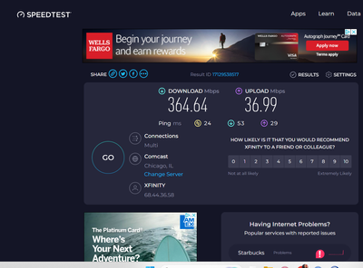

OK, getting somewhere. Now the question is, why the slow speeds now from the units? Below is speeds from the unit that is closest to the switch and wirelessly. The second is photo from wireless direct from the wireless out of modem. Pretty drastic difference.

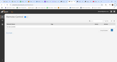

and when I am logged into ruckus unleashed from the browser (connected wirelessly on the unit) it shows nothing. I am having issues logging into the unleashed app from my phone and one of the blogs shows because the units may need a firmware update, but I can't do that without being able to log into unleashed from the browser.

Hi @Davepd3
You are using an incorrect URL. It's not unleashed.ruckusnetworks
Log in to your Unleashed system using a laptop web browser, either via the Master AP IP Address or https://unleashed.ruckuswireless.com/
Thank you again.

Everything has been done as requested. The speeds are still slow out of the access points. currently downloading at 367 Mbps
