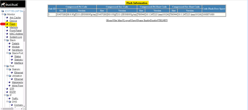

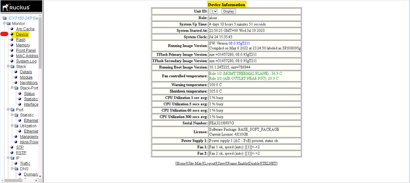

Imran_ruckus_0-1696549341096.pngIf you can log in, could you please share the screenshot showing the below information?
Imran_ruckus_1-1696549341104.pngImran_ruckus_2-1696549341113.pngImran_ruckus_3-1696549341124.pngPlease share the above queries and let me know if you have any queries in this regard.
