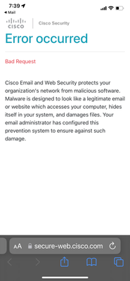

 I got this message when clicked the link for reset
Hi @ddwb41
Seems like you have security protection policies on your device that are denying access to the links I shared.
Please try it on your laptop/PC or any other device and let me know if you have any queries in this regard.
