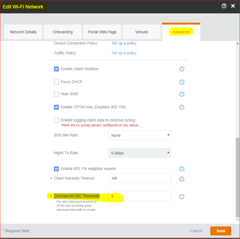

I am setting up a couple R720 APs for a client that is using them for a Listen Everywhere assisted listening system.  The AP's are setup using the Cloud Wi-Fi system.  The system is having issues with audio dropouts.  The manufacturer is helping to troubleshoot and is asking about different settings which I do not see available in the cloud.  Some settings seem to be available in the CLI, but as I read that is disabled when connected to Cloud Wi-Fi.  Is this correct?  Is there access to more settings via the Cloud Wi-Fi other than what is easily accessed via the menus?  (Am I missing an advanced area?)  I'm looking for IGMP, QoS, WMM or other settings that might be causing issues or that could help alleviate the issues.

Listen Everywhere uses mDNS to for device discovery, hence one of the settings which you should consider to play with is 'Directed MC/BC Threshold' under WLAN's advanced settings.
Set this value to '0'. When set to '0', this basically stops Ruckus APs to convert MB/BC to unicast for specific WLAN.
Image_ images_messages_5f91c454135b77e247a27fa8_c88eaa30233dffaf7d618418fe63650d_RackMultipart20200121430371ooc-ee7089ee-63d1-49f1-997c-562d3012ca6e-1512624402.png1579603336
Apart from this, if the Listen Everywhere server and clients are connecting to two different VLANs/network, then you have to configure bonjour gateway, because mDNS is layer-2 protocol, which means it will be limited to single broadcast domain, until you configure a gateway (bonjour gateway) between source to destination VLANs.
