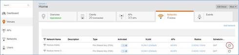

2) Can i setup Scheduling of AP's SSID's ? i don't need my WiFi to be running on Sundays and weeknights.

Time-based scheduling of WLAN availability can be configured by going to Venues->select your Venue->select the Networks tab for that venue->right hand side you see a Clock icon as below which allows you to set the on/off schedule.
Image_ images_messages_5f91c443135b77e2479f264f_d38f2be105879dedbd2f458bb20817ff_RackMultipart20180628704726tep-c25a107b-dbcf-46cc-89c2-e2b2f66d3c3f-1270237387.jpg1530156037
