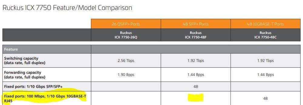

You can also refer the below screenshot for you reference that 100 Mbps is not supported:

According to the datasheet, The 7750-48f variant does not support 100 Mbps.
You can refer to the below screenshot for your reference:
