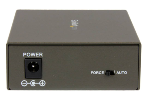

My customer using ICX7150-24P as Access switch and core switch, the connection between Core and access switch are fiber optic and UTP cable as the uplink. In between fiber and UTP cable, there is fiber media converter. My question is, did Ruckus required any special type of media converter?
This is due, the access switch down for too long. even after troubleshoot the cable, switch still cannot up normally. The switch can power up but cannot be detected in the network. Last option we try to change the mode at fiber converter from auto to force.
Image_ images_messages_5f91c3f3135b77e2478f609a_718a83079a6ed58374c81e394d603280_RackMultipart20181030180841irh-e88a1c67-5c3b-4f53-bc74-a741c78dd974-224964820.png1540890434
Did anyone have any idea how this issue can happened. Appreciate if anyone can explain further on this.

If U use 1 MC (not a pair), U should check the SPEED & DUPLEX at both the points - on the electrical switch port & on the optical core port. The SPEED & DUPLEX on both points must be UP in THE SAME. Here is 1000 BASE TX & 1000 BASE LX.
Check UTP - it MUST be use all the 4 pairs & correct RJ-45 montage (8P8C gigabyte).
U d avoid to use FORCE button, -  it isnt good for the L2 logical work of GE ports (MDI/MDIX).
