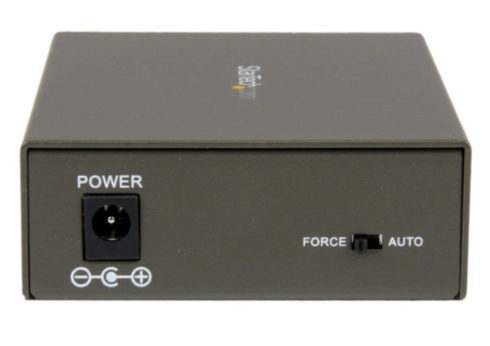

Regardless, you need to math the speed of the transceiver on the other side of the media converter. Hence, if you have a 100 Mbps media-converter, it will not link to 1Gbps on the other side.
When it says auto, that is probably for the copper UTP cable because generally fiber runs at only one speed depending on the optic types. Please do keep in mind 1000-full and auto although both may negotiate a 1000 Mbps Full-Duplex connection if you have one set to auto and the other full-duplex you will get CRC errors.
