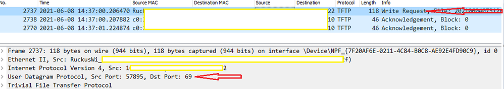

I have checked the pcap provided by you and can confirm port 69 is open on controller, as it is sending write request out from SZ (destination port 69) to TFTP server.
Image_ images_messages_60c0bcce8deabe3643094801_bc07d799b0e9237a6671544db64ad9d9_Capture-17fe540c-ae34-4ae0-8cf5-27bff522cf16-1829665601.PNG
After sending the write request, server is sending Ack block-0 but after that I don't see any information in the captures.
Could you confirm on what network node these captures were taken?
As a next action, we need to take capture on source and destination servers at the same time, so that we can see where traffic is dropping.

I have captured the logs on Laptop connected via Ethernet port.
I have also observed the TFTP responses, all requests are accepted still getting timeout error.
