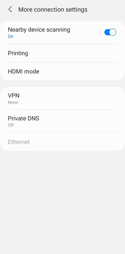

Hi Robert,
After investigating a similar issue with another customer we found out that there is a Private DNS setting which was turned ON, because of which the unleashed.ruckuswireless.com hostname did not resolve. Can you check if this is ON for you and can you test the app by turning Private DNS option OFF please?
