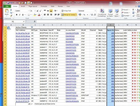

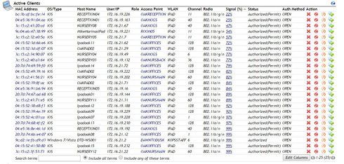

If I look at my ZD client monitoring page I see 25 ipads connected at present. As screenshot.
I'm only addressing your first query and then as a one-off scenario but it might provoke further "cleverness". I realise you want something far more elegant and automated but I don't know of it.
Image_ images_messages_5f91c40e135b77e24793c272_227f88753ee544c7179e8a3c5020fb78_RackMultipart20150309322151k6n-6d2c634e-6476-41c2-b327-1ee38e5317c6-350013214.jpg1425910600
I can then copy paste that data into XL. Another screenie...any help?
[This is a hands on non-automated kludge but at least it gives you something to play with!]

That brings up an interesting thought of having my software emulate a browser and copy and paste to a file, and then read the data from the file.
I need updates about every 5 seconds so some type of automation is needed, but you idea is very intriguing. Thanks!
