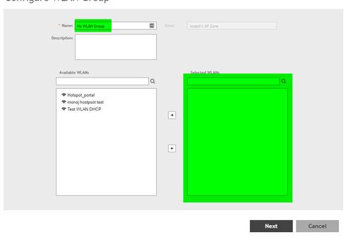

Please create a WLAN Group without selecting any WLANs in it and assign it to AP-Group or particular AP, now on these radios the SSIDS should not show up.
Image_ images_messages_5f91c463135b77e247a57634_1f588b730cc2b42fd9c4d8a931668a68_RackMultipart20170818941141jrw-0c309f32-90ef-456e-bc10-be173f9af595-1768808196.jpg1503063859
Image_ images_messages_5f91c463135b77e247a57634_08c517c4620e290f73168bdf498a9302_RackMultipart20170818922021t96-413bb9d5-607d-4d60-9284-73aba286fd69-1540664171.jpg1503063798
In case of ZD there is an option to enable and disable WLAN Services in the AP Group, but the same is not available in vSZ/SZ AP Group settings.
