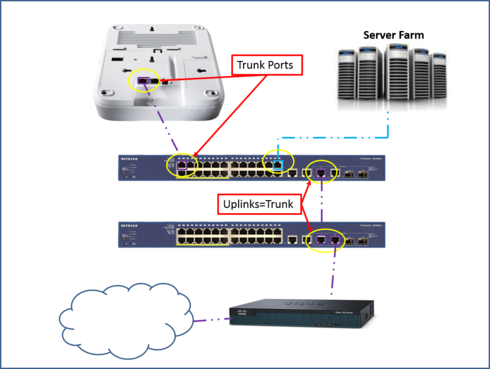

Is your topology is like this:
Image_ images_messages_5f91c470135b77e247a88764_8325182447be10097c95bfa7dd04d54d_RackMultipart20160203348071qux-9aab5bc1-7d01-4f4f-8104-9f3b029e07b3-1814202688.png1454492106
Sorry not exactly no.
I have the R300 Access point(one port) connected to--> netgear switch which is connected to another netgear switch that servers, pcs,  sonicwall etc are on and the sonicwall connects to the internet service
