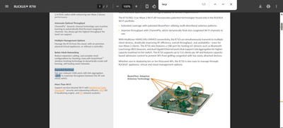

so as the r710 according to datasheet, it doesnt support LAG/LACP but still there is documentation on how to activate LACP.
also when checking the device details in unleashed, there is an attribute that shows LACP is disabled, so I guess there should be a way to enable it

The datasheets for the R710 and R610 indicate LACP support under the “Expanded Backhaul” section.
