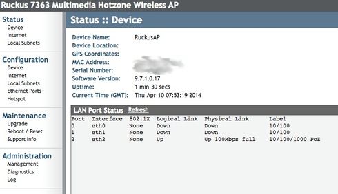

I recently updated our ZF 7363 AP with the newest hardware. However, upon restart, I currently have no options for selecting the wireless Radio's on the left hand side menu. I have tried to downgrade firmware and it all stays the same. Can someone help with this problem? It s a standalone AP. Here is a picture of what i see. Image_ images_messages_5f91c3e6135b77e2478d64f3_729e242e5f884cbb64846ed750374d90_ScreenShot20140423at4.12.40PM_-585c8cb5-8a0b-4b05-af9e-ad60198aeb65-1902595867.jpg1398240950

I did hard-reset the AP 3-4 times in a row with unplugging it a few times and it finally was restored to normal. It is in a working environment now with no problems. Thank you.
