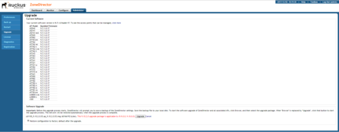

I try to upgrade to 9.7.2.0.32 from 9.7.1.0.17, the ZD1100 controller can upgrade to 9.7.2.0.32, but the Zone Flex 7982 was failure to upgrade to 9.7.2.0.32.
Then, I prepare to following the upgrade path.
When I find out the 9.7 release version
I cannot find the 9.7.2.0.16 from official supported website
https://support.ruckuswireless.com/products/29-zonedirector-1100#firmwares
So, If I try to upgrade to 9.7.2.0.32 again, I need to download 9.7.2.0.16 version?
Or I just upgrade to 9.7.2.0.9, it can upgrade to 9.7.2.0.32?

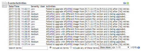

I have try to upgrade to 9.10.2.0.53 / 9.7.2.0.32, but when I successful to upgrade to 9.7.2.0.32, ZF7982 cannot upgrade from ZD1100 , the status"Failed to upgrade AP04 image from [9.7.1.0.17] to [9.7.2.0.32]".
Although, the version is 9.9.0.0.0.216 on this photo, but the situation is the same one.

I have try to directly upgrade to 9.10.2.0.53, but the ZD1100 alerted, the upgrade package is applicable to (9.9.0.0, 9.10.0.0.0)
Thanks
alexandre_allai
You can't upgrade directly to 9.10 you have to respect upgrade path or you will loss configuration.
9.7.0.2 -> 9.9.1 -> 9.10.2
ZF7982 are supported in 9.10.2 it should works well.
These "fail to upgrade" messages are weird, you should open a case for that.
I already try to upgrade 9.7.2.0.20, but I encounter the same situation "fail to upgrade". It is just 9.7.1.0.17 upgrade to 9.7.2.0.20.
9.7.2.0.20 also includes WPA2 KRACK Vulnerability fixes.
