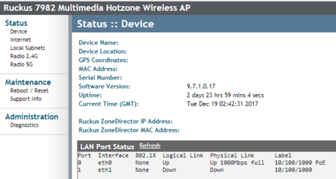

I try to upgrade to 9.7.2.0.32 from 9.7.1.0.17, the ZD1100 controller can upgrade to 9.7.2.0.32, but the Zone Flex 7982 was failure to upgrade to 9.7.2.0.32.
Then, I prepare to following the upgrade path.

The ZD1100 & zf7982 version of firmware is the same one 9.7.1.0.17
but it cannot upgrade to 9.7.2.0.20. Then, the log will show"fail to upgrade".
Image_ images_messages_5f91c477135b77e247aa6348_a708642ada948ba78e7782d05facd225_RackMultipart2017121953781r03p-1d7c74c4-2cf6-4f45-8a81-1ee0cd28a52f-656564074.PNG1513651737

I agree with Thomas, who suggests factory default of you 7982 AP.
Locate it on the same switch/LAN as your ZD as your trying to get it to upgrade.
APs should install a matching version firmware that they get from the ZD.
