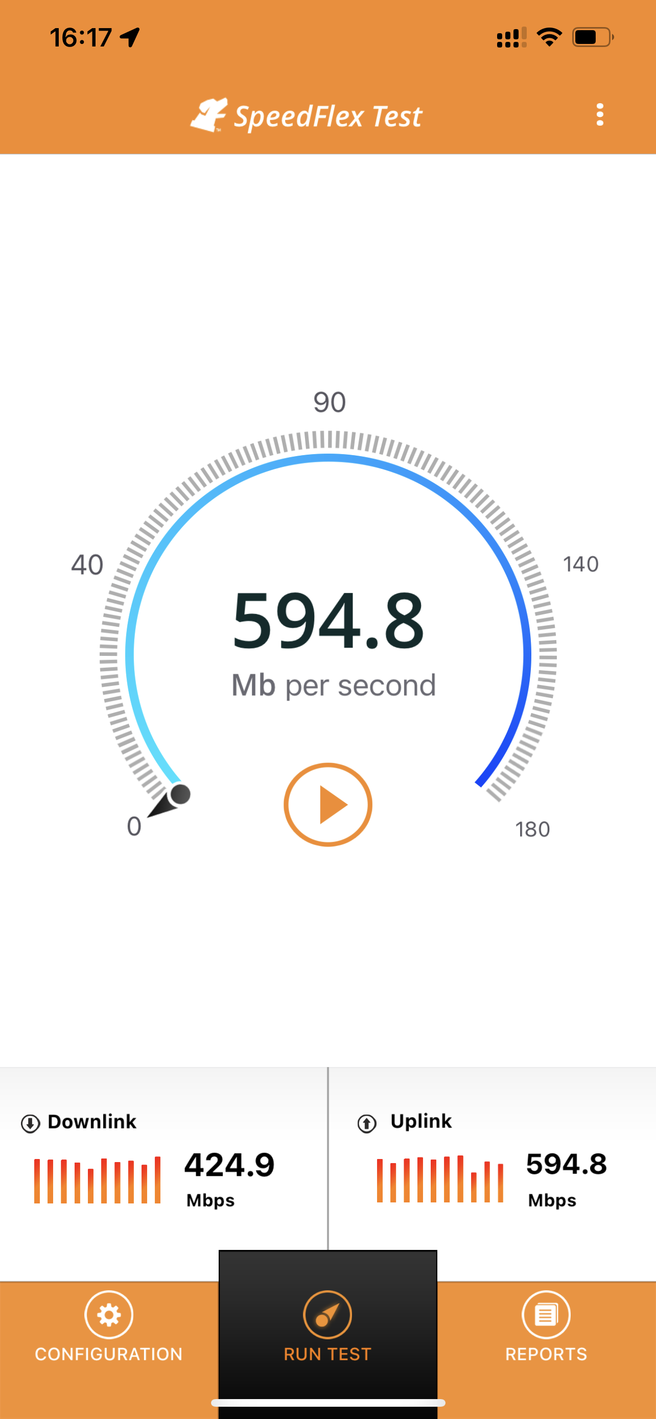

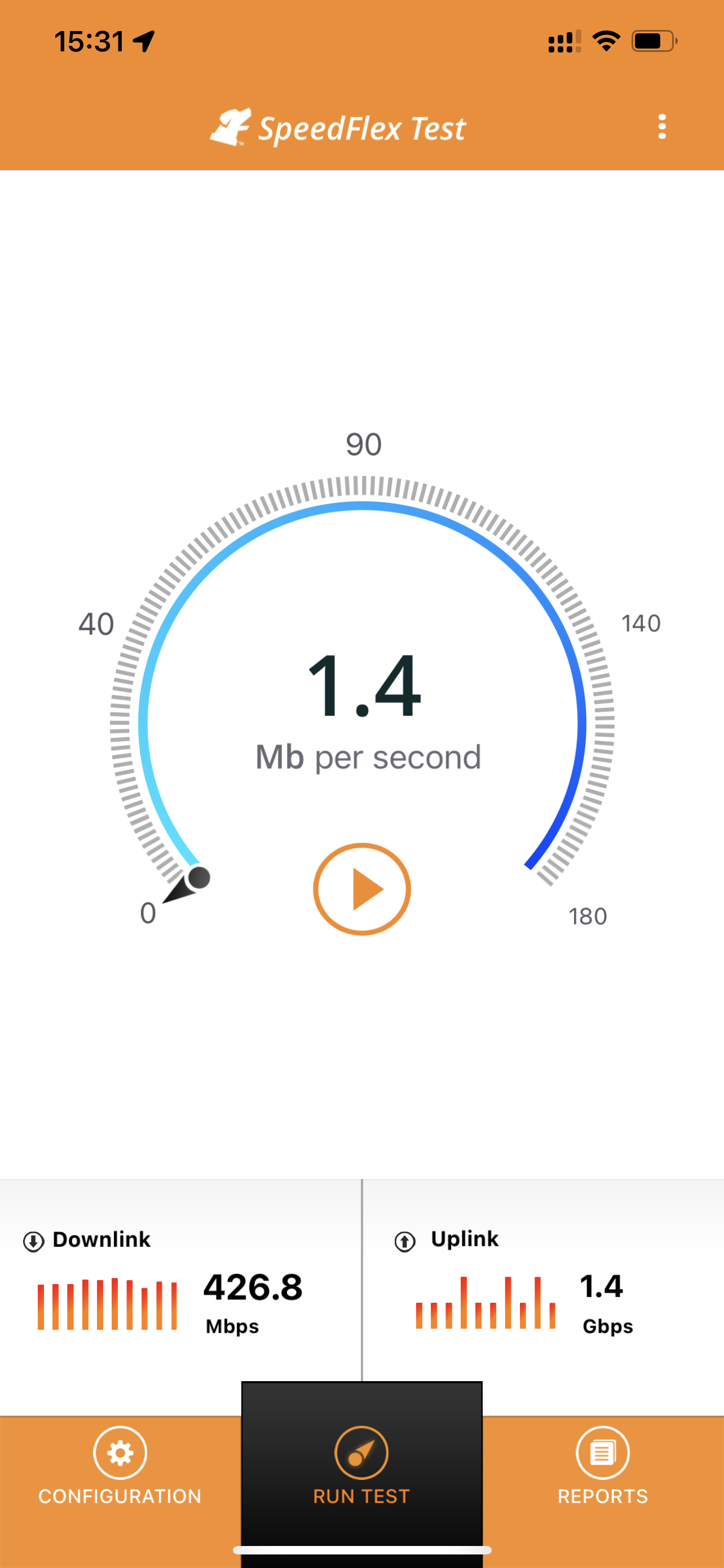

1/ I try to use Speedflex App on my iPhone iOS (12 Pro Max) to test speed to AP.

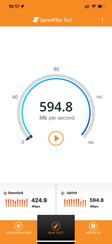

With R700 Standalone (latest firmware):
- Downlink: 424.9 Mbps, U: 594.8 Mbps

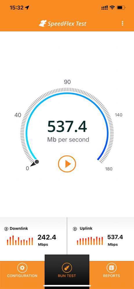

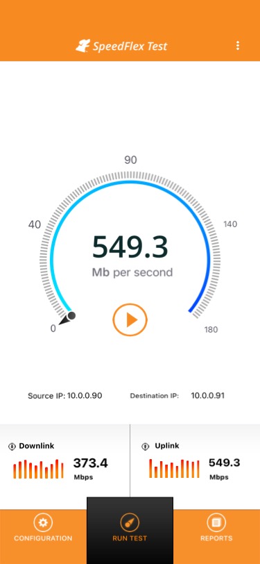

With R710 Unleashed (latest firmware):
- Downlink: 242.4 Mbps, U: 537.4 Mbps

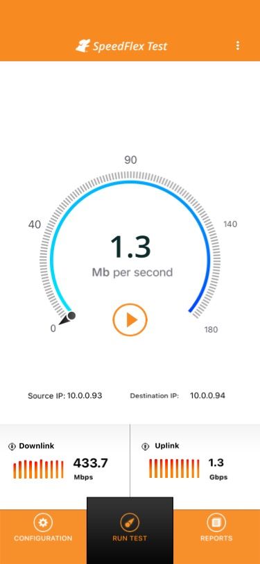

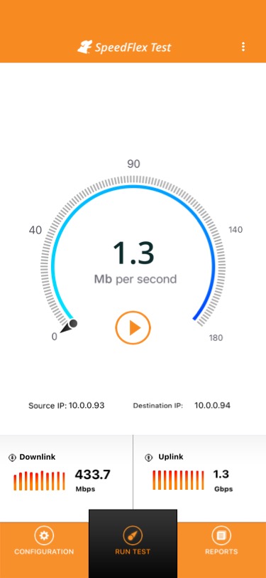

With R850 Unleashed (latest firmware):
- Downlink: 433.7Mbps, U: 1.3Gbps

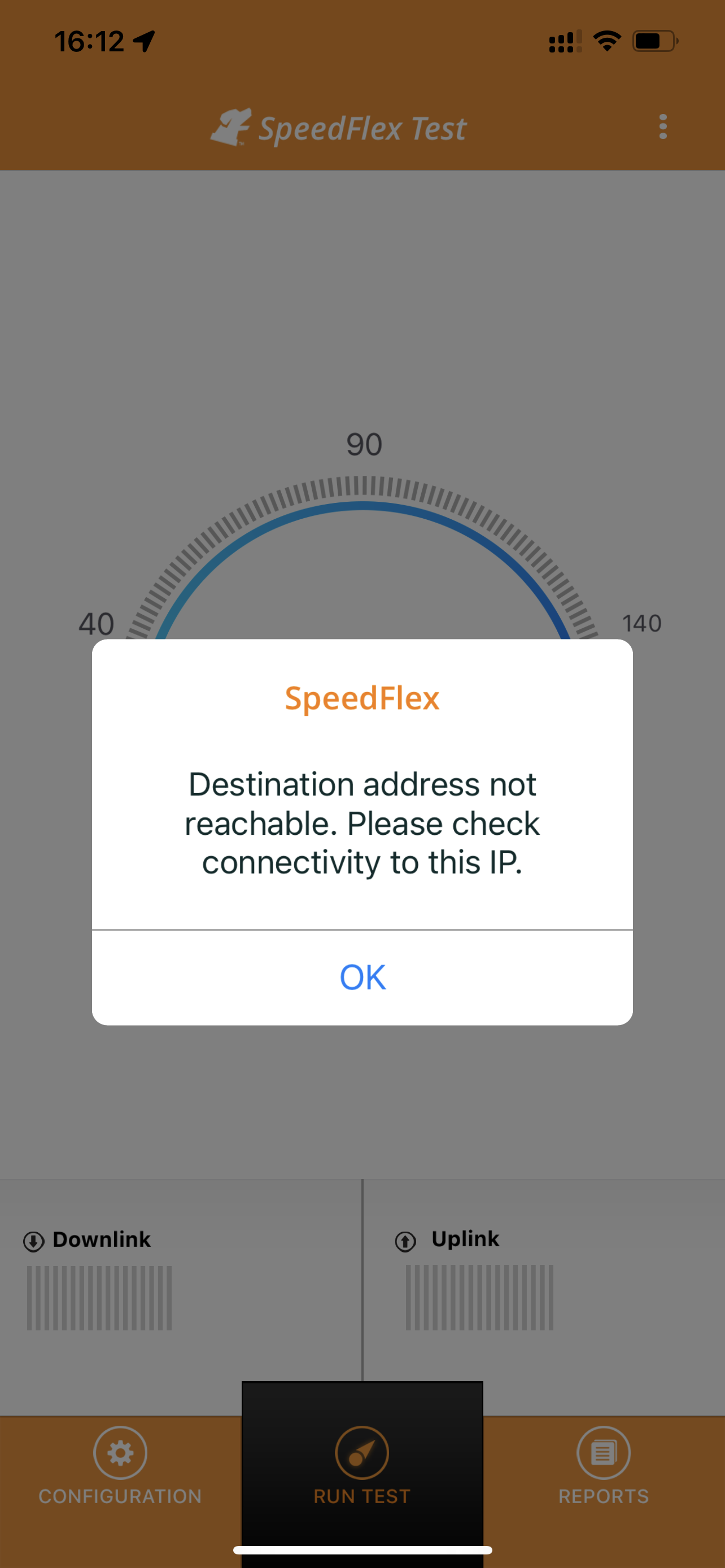

With R850 Standalone (latest 114.0.0.0.5585):
- Always ask to check AP IP (may be app is old)

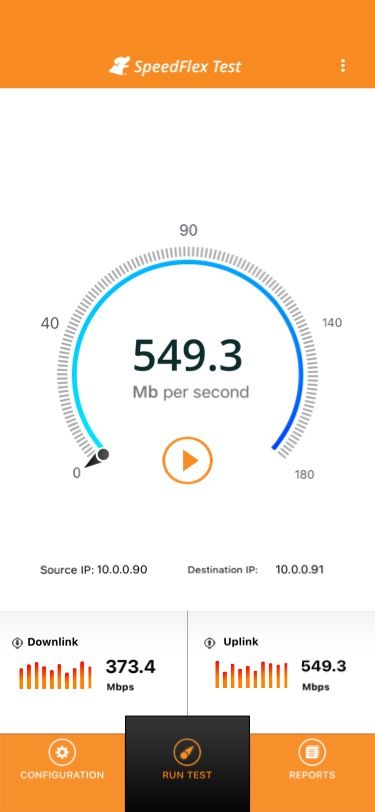

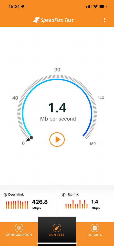

So please help me why the Uplink is always low? How can I improve this? How can I explain to my Boss 😄

Hi @kazihaha
The speed result between the AP and client via wireless is based on multiple factory like RSSI, SNR, Radio band, Channel bandwidth, MCS rate, etc. Based on the client condition the result varies.
Also, when doing the speed flex, the AP generates the traffic which utilizes the AP resource, resulting in the less speed in the GUI. Higher models has higher specs.
You can log a support case so that we can check the if this is caused by the client condition or something to do with the SpeedFlex.
