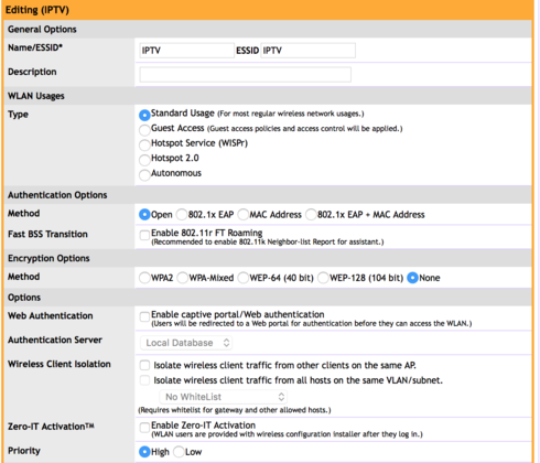

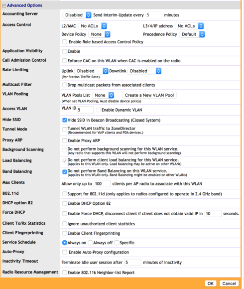

Where would i need to add an IP. Don't see any option to add a IP. See screenshot of WLAN setup. just to confirm, i don't want to stream wirelessly. Stream needs to go through the Lan 2 interface. TV is Hard wired to the AP.
Image_ images_messages_5f91c43c135b77e2479d58af_dcd052fd970530c941b2cdb57bfd7606_RackMultipart20170821803983v7b-35c86e4d-3bbd-4936-83fd-7c72bf85c44e-1052156220.png1503308116
Image_ images_messages_5f91c43c135b77e2479d58af_d5b8a65e2be84884542c50f2e2ba0ffa_RackMultipart201708218329912h2-80e42a57-abdf-426e-a084-ecd0cdc26a7e-1638335429.png1503308162

apologies, i was under impression that TV's connect to AP via WiFi...so certainly AP is messing something up...
