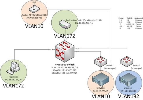

Hello i need to set up an AP with two WLans one should be in the Vlan 10 and one in the Vlan 192 but i dont get what i do wrong. In this Picture you can see my configureation.
Wlan1 should get the ip-adress by Server 1
Wlan2 should get the ip-adress by Server 2

When you define the two WLANs, use advanced options to tag one with VLAN 10, and one with VLAN 192.
Then, most importantly, AP switch port must be in Trunk mode, and include VLANs 10, 192 too.
07-14-2015 04:47 PM
Oops, looking at your AP which has 10.10.10.199/16 in VLAN 10 IP address, I expected the AP to be in VLAN 172 like your ZD, so AP/ZD on VLAN 172, and client traffic goes on tagged VLAN 10 or 192.

VLAN ID 10 = SN
VLAN ID 172 = BARUCKUS
VLAN ID 192 = VN
Hi this is my new VLAN-Configuration
The unmanaged Switch1 is connected with Port 1
Switch 2 with Port 8
The ZoneDirector with Port 9
and the AP with Port 10
The Wlans are Tagged with the IDs but if i connect with them i get no IP by the DHCP
