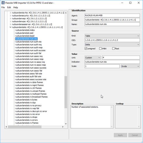

Jerry,
You could also use the Paessler MIB Importer to try to find your OID.  It provides a a description for each MIB.
Image_ images_messages_5f91c466135b77e247a5f919_3d796278b296ee96cedad43620d1afb8_RackMultipart201612021146431e2-0ee8f2f4-cb7a-4348-bea7-7f8e1b4b5060-366568209.jpg1480694461
