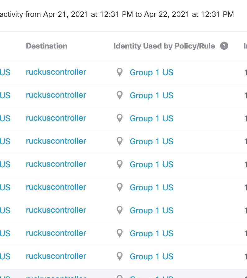

If DNS is logging, are you able to see the AP asking for "ruckuscontroller"? I'm just curious. Your instincts are probably spot on. This DOES sound like a support issue.
Image_ images_messages_6081cf787d10177233200bde_bf71dd36b28da021898ac4c400960a9b_ScreenShot20210422at12.32.24PM-a82717cb-d174-4a97-b913-fd421ec0e5aa-1654328850.jpg
No, it doesn't use DNS. All i can see is the Juniper DHCP logs and ARP tables. The AP does not show up in the SZ either. So tomorrow is another day. 😉
