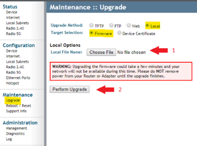

Yes, you can download the latest Unleashed software version for R710 AP Models:
RUCKUS Unleashed AP 200.14: https://support.ruckuswireless.com/software/3730-ruckus-unleashed-ap-200-14-ga-refresh-2-software-fo...
Then, browse into the AP's IP Address, login and perform a Local upgrade:
Same process will be for the rest R710 APs.
Here's the RUCKUS Unleashed User Guide, you'll find how to complete the initial setup, create the WLANs and further:
RUCKUS Unleashed 200.14 User Guide: https://docs.commscope.com/bundle/unleashed-200.14-onlinehelp
Please let me know if you have any questions.
