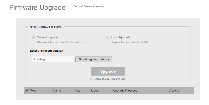

The ruckus in unleashed mode looks weird because i cannot upgrade via the web browser does not show the AP.
