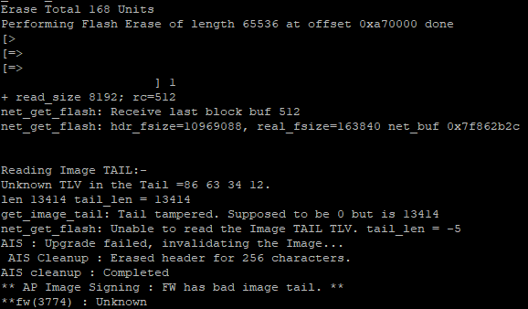

But now i am having an issue with the compatible firmware to downgrade to Standalone.
I am using this fw version = T300_110.0.0.675.bl7
But when i try to upgrade gives this error:
Image_ images_messages_618b979ccb9df774cea5c8a1_afa49f7caf6963ded517f0737e28ca90_imagem_20211110_095742-897dd151-9199-47e7-8b80-7fd23cbf5bbb-1907729158.png
ryan_winland
I think the file size specified in the configuration file and size of the file received do not match (i.e. hdr_fsize=10969088 vs real_fsize=163840).  Please make sure the firmware images passes checksum verification and that the exact file size in bytes is specified in the configuration file.  Also, please ensure that the network connection between the TFTP server and the AP is rock-solid.
