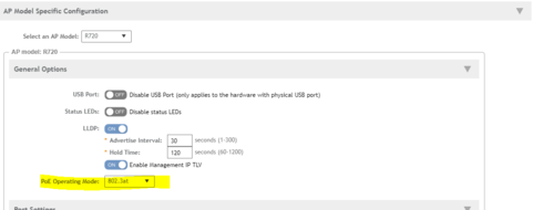

Hi David,
I remember in the past, if you aren't fully loading your switch with just APs, we'd recommend to try spacing them out across the 4-port blocks, which are typically powered by the same internals. The advice was alternating top/bottom ports, so kitty-corner two APs in the 4 port sections.
If you used half the PoE+ ports on APs, and all lower class PoE phones/other devices, I think your power budget should still suffice. I hope this helps.
