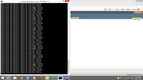

I am having this exact issue. Have you had no further issues since disabling and renabling your wireless card Adam? I have never experienced this with any other AP, it's a bit of a concern... Image_ images_messages_5f91c413135b77e24794da7b_66a58936e4dd6369efde1ef2a670a5a5_Litsoninstallpings_inline-a8e275f9-8bd9-45c5-ad39-88529d7ded44-565777970.png1384376796
