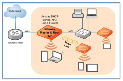

Please see page 188 and 189 of the user guide shared in the previous response.
Gateway Mode
An Unleashed AP must have at least two Ethernet ports to support Gateway mode.
Gateway mode can only be configured during the initial Unleashed Master AP setup wizard process. Once enabled, it cannot be disabled without factory resetting the Master AP.
Gateway mode provides a solution for SMB customers who need to provide private addresses for clients and do not have an existing gateway router, or who connect to their ISP over PPPoE. Enable Gateway mode to provide Network Address Translation (NAT) and DHCP functionality to assign private IP addresses to member APs and clients.
Gateway Mode
