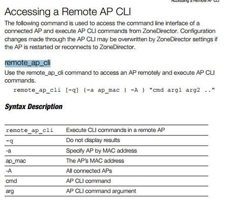

edited: may i know if i want to direct use zd command what remote_ap_cli -A "set http enable" -A means? is it the IP Address? where can i get this full cli command reference?
i've tried download here:
https://support.ruckuswireless.com/documents/690-zonedirector-9-10-ga-cli-reference-guide
but keep getting the same page..
nvm, i got it..

The remote_ap_cli command uses the AP MAC to identify and apply the AP CLI commands
-a is used to send the command to a specific AP
-A sends the command to all connected AP's.
