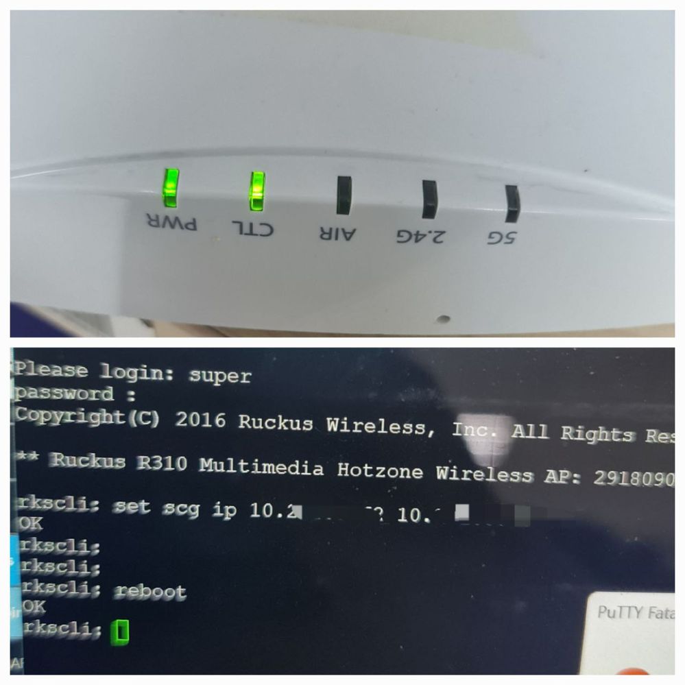

wanji
photo_2024-06-28_14-41-17.jpghi james...thnks for reply....after upgrade AP firmware to 104.0.0.0.1347....the ap cannot connect to virtual controller smartzone...before this using old firmware 102.0.0.0.5, IT CAN CONNECTED TO VIRTUAL CONTROLLER SMARTZONE...pls help
