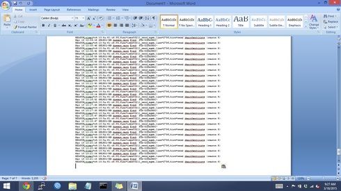

Here are the errors I'm getting from the log file. I need to get this resolved as soon as possible because I need to start putting customers on this link. OUr distance is 27KM. and the throughput is between 1-3MegImage_ images_messages_5f91c46c135b77e247a7980f_2bd26c3d2af57b96555796f225bf94a2_RackMultipart20150318282911pq8-cfb17192-33fd-4f22-a72d-ba6643469139-2077138593.jpg1426685491

As per log messages, NRB is getting deautheticated because Class 2 frame received from nonauthenticated STA. this happens because NRB attempted to transfer data before it was authenticated.
this is happening almost every minute.
I think this is NOT a real issue but a transient one. You mentioned that link is for 27 KM and is it using external antenna? Is it aimed correctly?
Can you reboot the link and then run the test. Does it give you a better results?
Is the throughput degrading over a period of time?
