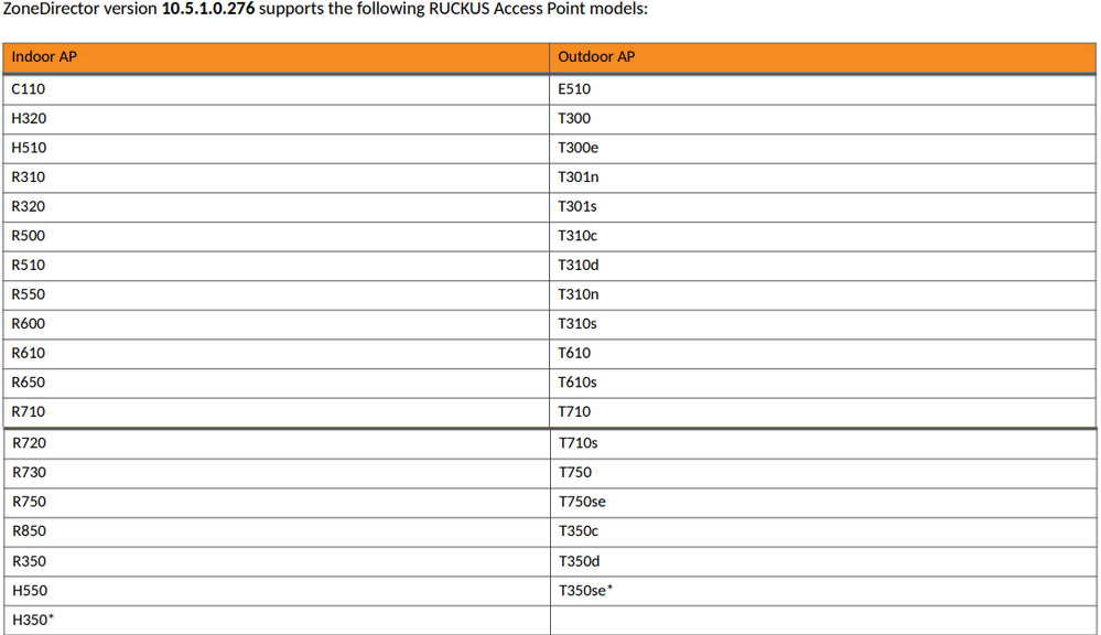

Hi @CAIQUE
That was the list from the ZD's version you shared 9.13.3.0.164.
Please find the below list of ZD's latest version 10.5, if you have support then you can upgrade to have the below APs on the ZD. Many APs are latest models.
