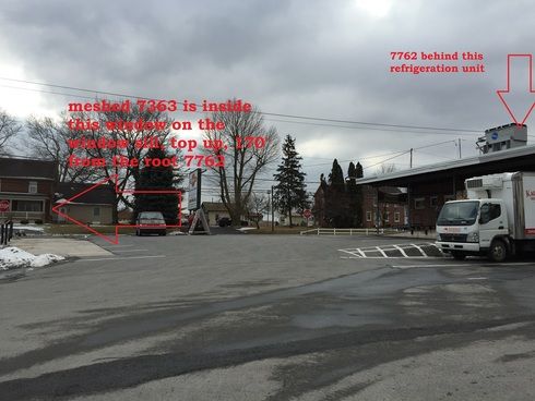

lonnie_3404113
Contributor
Photo, including a screenshot of the NORMAN 7363 and its from/to values today.Image_ images_messages_5f91c409135b77e24792a684_d67e9ca5423e7b3f54b698faf07b764b_RackMultipart20150212165477o4c-6fa7258b-44b3-4e77-a397-f199a8f36536-564558056.jpg1423763909Image_ images_messages_5f91c409135b77e24792a684_e7c1ca73650fa7be5fedd5319473495b_RackMultipart2015021213902kdtg-a6526f39-ab99-484c-8dc6-60d16c6814d8-1687086790.jpg1423763957
