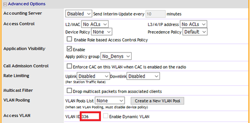

This is accomplished by configuring the VLAN ID within the Advanced Options of the Configure WLANs tab (highlighted in Red below):
Image_ images_messages_5f91c46e135b77e247a827dd_ca10515def51c416c526753e270593c6_RackMultipart2016012312274ih4u-827a272d-1643-40a4-89db-7008b1e3c6e9-74081551.png1453511159
