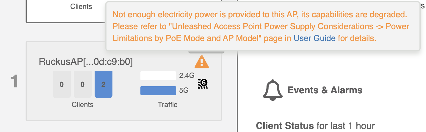

Hey Everyone,
Per the R750 PoE+ power spec I shouldn't be seeing this issue either. I have heard others say they are using a 60W PoE injector.
Image_ images_messages_5fbe5b76afb7982602861148_1fcc0da578bffaebb569d1912bc1f203_ScreenShot20201125at4.50.36AM-ffe90c9b-a2b1-4a6f-8479-ebbcbaf7259d-2112390709.png
Using a...
Cudy 30W Gigabit PoE+ Injector Adapter, IEEE 802.3 at and IEEE 802.3 af Compliant, up to 100 Meters (328 Feet), 10/100/1000Mbps RJ-45, POE150
Image_ images_messages_5fbe5b76afb7982602861148_ef602b97bd9301d3630e83fc42c2e3d2_ScreenShot20201124at4.59.26PM-7dbd9ac0-fec4-43b2-aa32-0f19b8573c21-388883851.png

Apparently, your PoE adapter is not able to supply the required +25W. Happens more frequently, than you would like to know.
So the Cudy is not very high quality or the specs are more needy than they say, or a firmware issue as some stated the earlier releases didn’t have this issue.
seems like more in Ruckus side if I had to guess based on all the feedback in TCH link.
Thanks!
Follow your guts. The poor PoE specs is my personal experience. Maybe your customer has a PoE or a PoE switchport you can borrow ? Just to eliminate this as an error source ? Otherwise maybe downgrade to 200.8 ?
