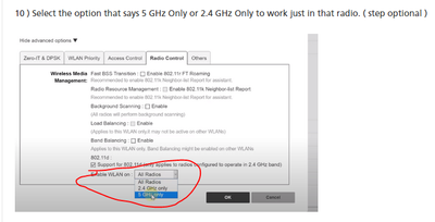

I believe this guide can help ( step 9 and 10 ) you although the version you are running is a bit old
Creating a New Wireless WLAN (SSID)

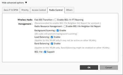

Unfortunatly i do not have the option mentioned under 10)
From guide
Screenshot from my AP
Do you think that is because of the old software?
Best regards
Morten
