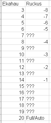

But that ads some confusion too. What is Min then and I'm guessing Full/Auto would be 20dB? Also looking at the chart below 15dB to 19dB there is no way to set that as the option is not available in Ruckus?
Also is there no way to see in the dashboard what each AP is transmitting at? All I see is the Tx Power Adjustment -3dB but it would be nice to be able to see it in a normal way if it is at 14, 17 or 20 etc.

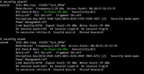

I am sorry, Mitchell is right; I got wrong with Units; which changed entire calculation.
AP:R610, Country Code US; Firmware:3.5.1.
Auto/Max 2.4Ghz Radio 18dBm
Auto/Max 5Ghz Radio 20dBm
Min 5Ghz Radio 2dBm
Min 2.4Ghz Radio it is usually 1dBm; this should still need verification.
Now, you could calculate your Tx accordingly, say if you set the Tx power -1dB then your Tx power of AP would 17dBm in 2.4Ghz Radio and 19dBm 5Ghz Radio.
Please note, this would vary according to country code and MCS rate.
