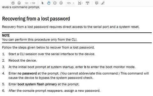

I leave you with the formal instructions for password recovery... looks like exactly what you already tried.
I took a look at the FastIron Configuration Guide, 07.0.30 and verbatim this is what it says:
