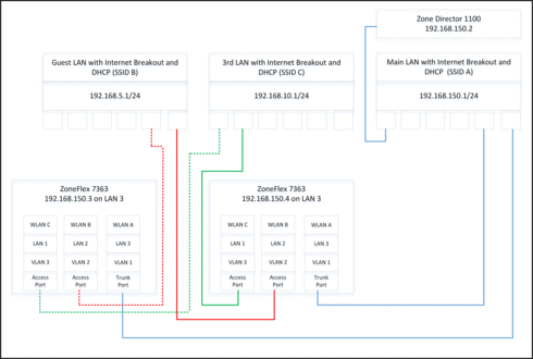

I'm trying to configure three separate WLANs to run off my two ZF7363 APs,
using a Zone Director to handle the configuration.    I've got three separate physical LANs, and want to cable the three ports on the ZF7363s to each network, giving each network a separate SSID.
My setup is as follow:
Image_ images_messages_5f91c3ec135b77e2478e7b55_0ddce35cfa8b6a625014387413966120_RackMultipart201710063242837zx-9daae558-80c6-4f21-8445-816dbfa2f088-1984042840.gif1507291348
Everything works like it should until I connect the LAN 1 and LAN 2 cables from both APs into the same switch.  So AP1 wired into all the switches works fine on its own, and AP2 wired into all the switches works fine on its own, but not together.
Any idea where I'm going wrong with this?
