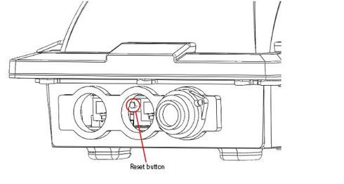

How do I factory reset the ap?

You can reset the AP to its factory default settings by pressing the reset button that is  located next to the RJ-45  PoE OUT  port.
1. Use a 27mm socket to remove the middle RJ-45  PoE OUT  cable gland.
2. Make sure that the AP is powered.
3. Locate the reset button next to the RJ-45 port.
4. Using a pen or a similar pointed object, press the button for 10 seconds.
5. Verify that the  STATUS LED on the AP is off. If the  STATUS LED is off, it indicates that  the reset process is complete.
See the attached screen for button ref .
Let me know if this helps.Image_ images_messages_5f91c421135b77e24797997f_8b784f325dd3b759e2d8093233c9e4d5_83261b69wql_inline-aa2d8837-d092-490d-96ac-8c81738f97d0-852899220.JPG1430134365
