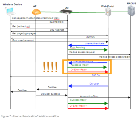

I am building a cutsom secure hotspot following the guidance in the Ruckus Tech Note "Configuring Hotspots with Secure Hotspot". When I set the HostSpot Authentication Server to anything other than "Local Database" all I get back for known valid users is a 202 Authentication Pending response. Can anyone advise on how I might resolve this? Ideally I am wanting to use an AD server for authentication and this works fine for WLANs - it is only when used in a HotSpot that it fails.

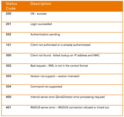

Firstly, yes, that is the Tech Note I have worked from. Taking the chart on page 24 as a reference, I am getting as far as step 6. The "response-code" in the XML coming back from the Zone Director is consistently a 202 if I use AD or Radius as the Authentication Server in the HotSpot configuration; if I use Local Database I can get a successful 201 but this is obviously not much help (beyond establishing that my server-side code is working). I get the same response when I use a request generating tool such as "PostMan", so I know I am sending the XML to the ZoneDirector correctly and I am getting valid XML back. I just don't understand why credentials known to be good (and tested in the AAA config page) are producing the 'Authentication Pending' response.

You need to send another request to check user status. This request completes the auth process. There is the XML below
The tech note http://a030f85c1e25003d7609-b98377aee968aad08453374eb1df3398.r40.cf2.rackcdn.com/support/secure_hots... doesn't clear point us to this command.
