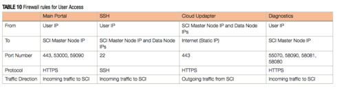

Hello, I just wrote a KBA-7590 for this issue. https://support.ruckuswireless.com/answers/000007590
Spinning wheel under some Admin screens after upgrading, was only seen under FireFox (latest Chrome has no problem).
It may be necessary to unblock some Admin ports in your Firewall for FireFox.
You can quickly verify if ports are being blocked under FireFox by trying to go to the following link:
https://[SCI-IP-Address]:53000/api/v1/clusters
and click on "Advanced" link/button to add the exception.
